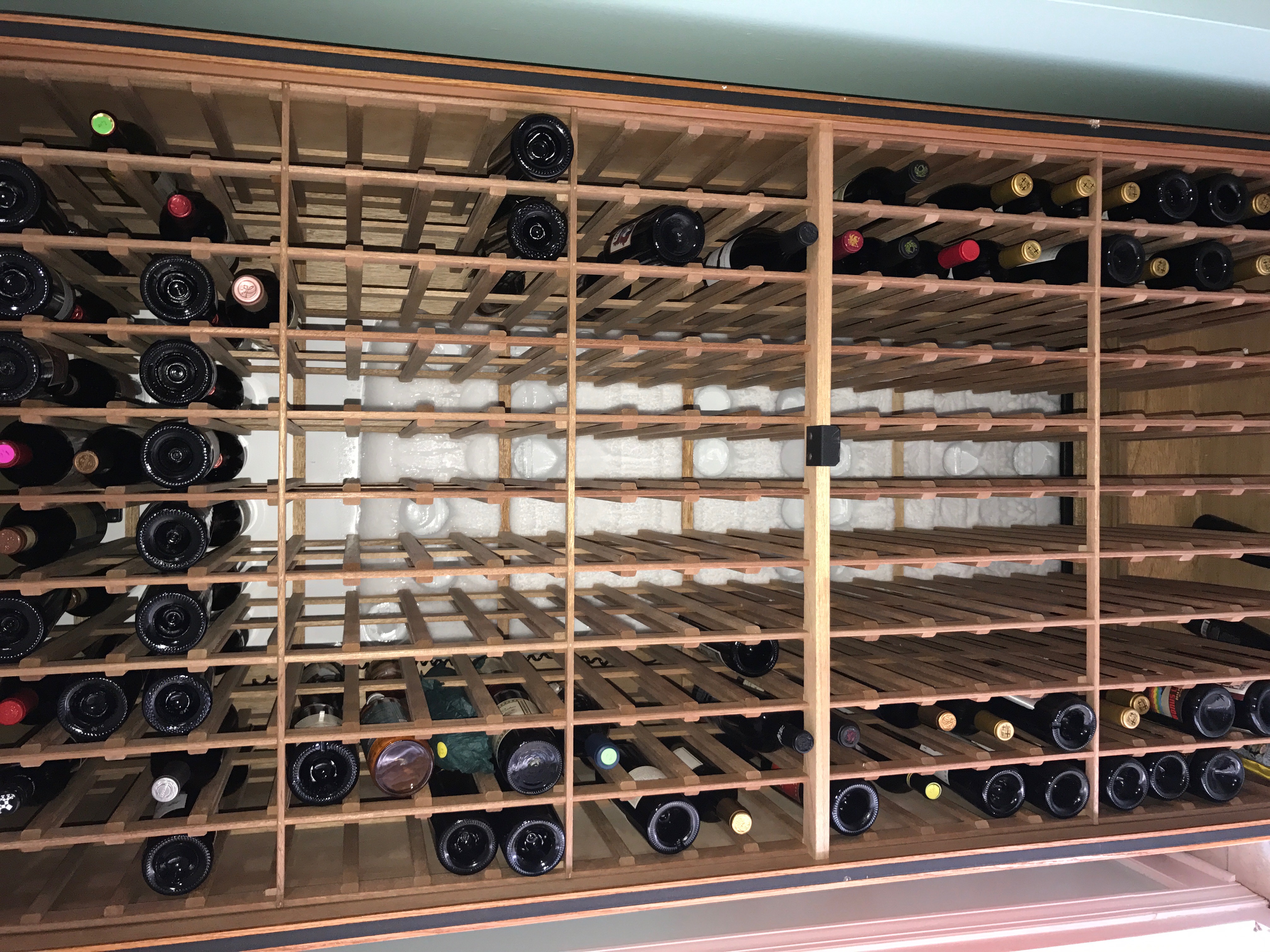

3So back in 2007 my closet was overflowing and the little fridge I bought quickly filled up. Like it took a week. DOH!
I went on Craigslist and found a killer deal. A 440 Bottle Vinotheque, worked great, just needed to get it from the person that day. It was like $800 and the person and bought the house, with the cellar in it and they didn’t drink wine. So the wife wanted it gone, I scored big time.
Fast-forward…Three moves later, I still have it. In the last move, things didn’t go well, mostly because I let someone else move it instead of doing it myself. sigh In one area, the door doesn’t seal and warm air gets in. On top of that, the compressor will make a sizzling noise while it’s cycling like once every hour or so.
So summer I unplugged it because it was too noisy for my guests who were staying in the same room as the cellar and we noticed water on the floor…Upon further investigation, we discovered that nearly the entire back wall was frozen, solid. (Sorry, the picture isn’t auto-rotating after upload.)
First of all, ugh…I hope none of the wine was damaged by being so cold for an unknown amount of time…Though I don’t think it was THAT long. So far, everything I’ve drank since was fine!

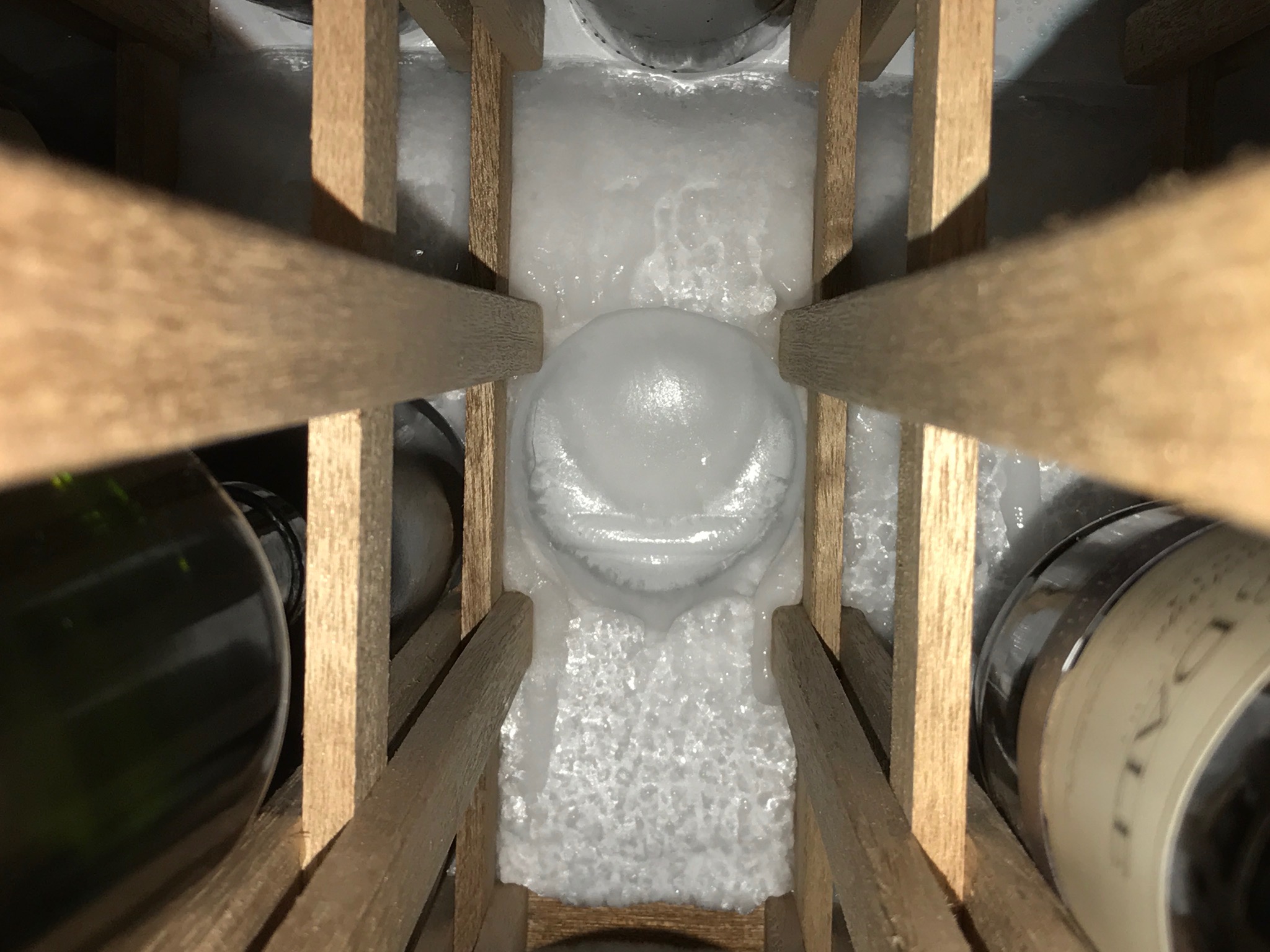

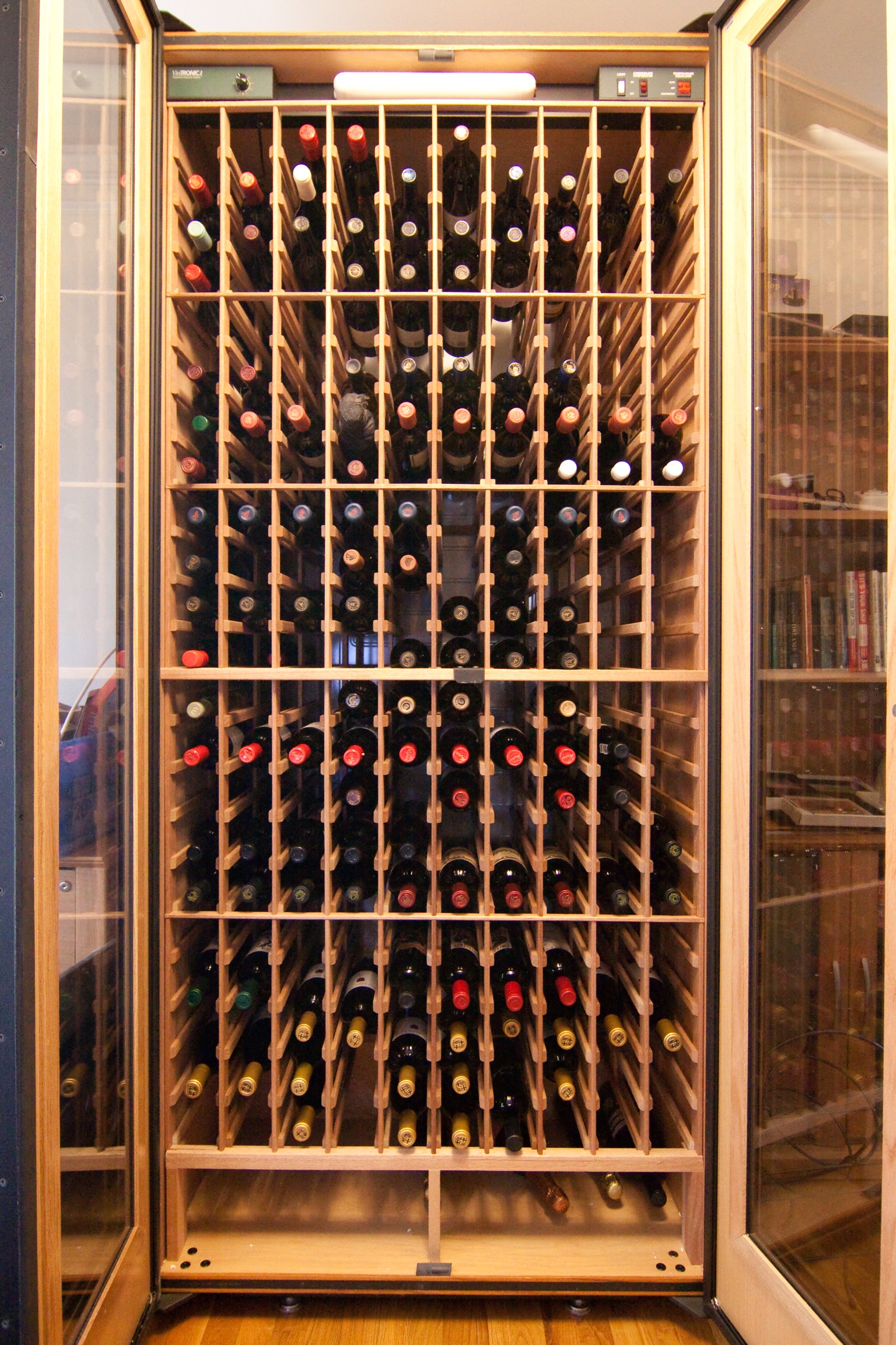

Would you expect that much ice to build up just because of the seals being compressed? I’m concerned it’s a bad sensor or something, but maybe it’s the seal alone. Maybe it needs coolant?
I called Vinotheque a while ago to find out what the seals would cost, it was like hundreds of dollars…I want to say $200-$300. The new sensor would be at least that as well, if not more.
I’m concerned that performing any repair, except for maybe trying to do my own seal repair, is probably not a good investment. I’m concerned that this will become a cellar pit, sucking in lots of money. Living out here in VA, I had called around to find out who might work on something like this, everyone said they would not…

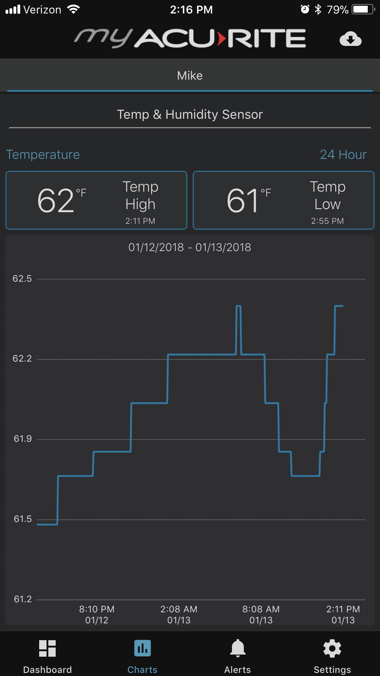

In the mean time, I got a temp/humidity sensor that ties into my weather station that I already have…so I’ve started to monitor it. I am hoping that at a minimum the temperature fluctuations will be limited since the cellar is mostly sealed. I know that temperature fluctuations are the worst thing for stored wine. Right now, it’s hovering around 62 and 47% humidity…I haven’t had it long enough to see how much it fluctuates week to week, though intraday seems to be pretty stable.
Anywho…wondering if anyone else has struggled with something like this. Really don’t want to spend much on any solution, frankly, I’d rather use the money to buy wine and am not intentionally building up a collection for epic aging…This is all just a side-effect of @winedavid49 providing good deals on great wine. Meh.

Looks like your evap coils are at the rear of the box.
With a failed seal you’ll have air transfer, it’s not the warm air, it’s the water vapor in the air, and if the humidly in the air is high enough it will condense on the cold surface. So, replace the seal. I did mine when I refurb’d a used box I purchased. Don’t recall where I got the seal, but I’m sure google played a part. Your seal looks to be magnetic and seals against a ferrous strip. Mine was the same. They will fabricate whatever size you need.
It’s getting cold; unlikely you need refrigerant.
If it is cycling and maintaining temp, the controller is likely fine as well.
Get the ice out and see how the temp holds, but without the seal fix, expect more to build up in a high humidity environment.

While I would agree in a freezer situation that having the ice build-up is just an annoyance, I’m concerned about the back of the bottles sitting in ice, and the reality that the front of the bottle won’t be as cold. That should mean that internally, the wine would be “flowing” as the heat is exchanged from the front to the back, etc…

@vaaccess Under one degree!? You’re golden.
When it’s loaded the thermal mass of the bottles/wine will move even more slowly. Were you to instrument the wine (water) inside a bottle with a probe and recording meter I’d expect only tenths of a degree variance. Does it chill well to the mid 50’s? What kind of a duty cycle you seeing on the compressor?
Wait. That’s off? So just daily internal fluctuations?
But with bottles inside. Under one degree is not an issue.

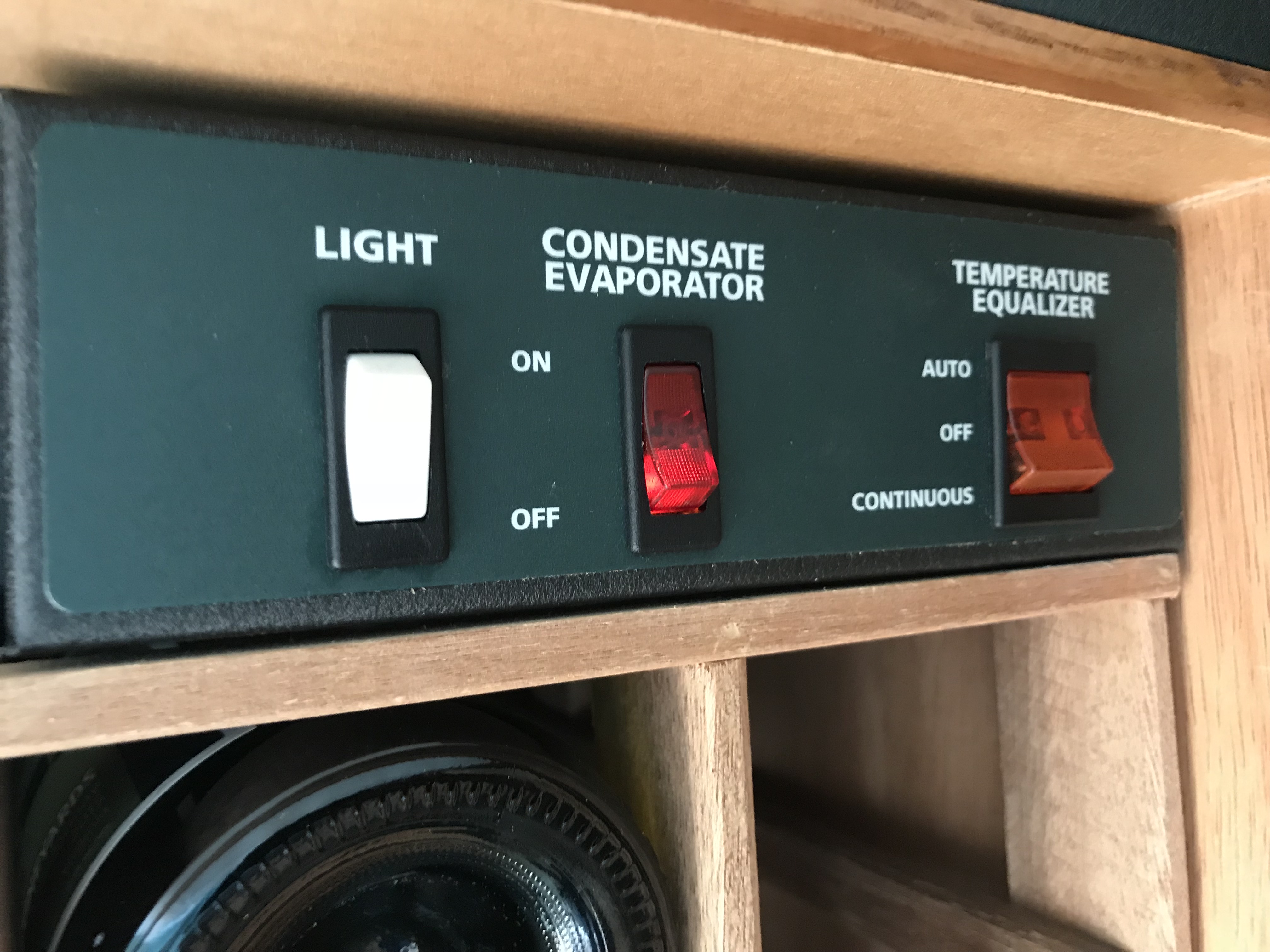

@rjquillin another question, given the situation, do I want the condenser evaporator on? It’s a separate switch.
And yeah. That was just the ambient temperature inside. One reason it was stable is that the air temp was around that inside and outside so not a big deal. It’s about to get cold again, though. Summer is my biggest concern.

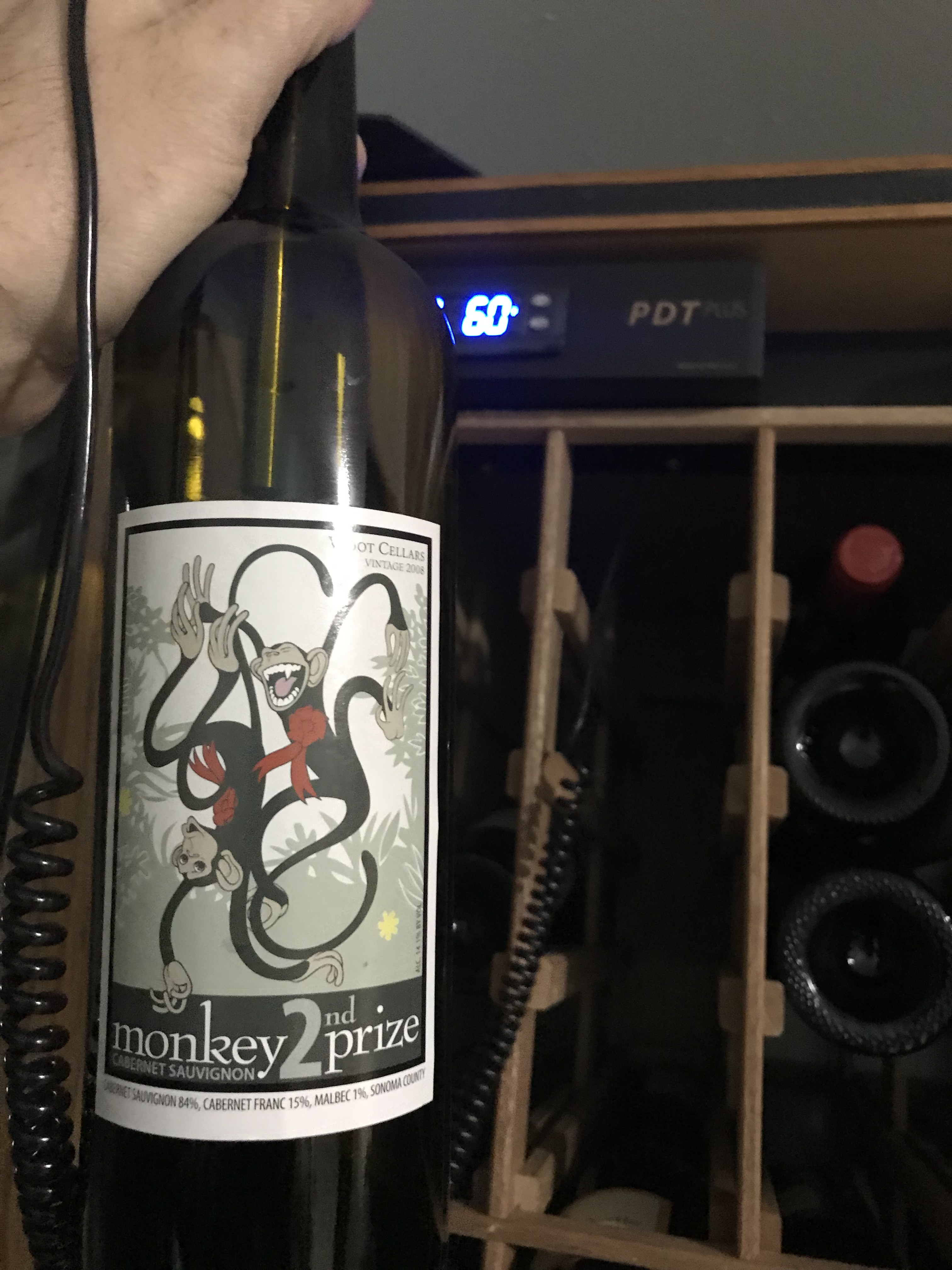

The cooler temp itself is driven off of a probe in a bottle that I filled with water. I don’t have a way to test the internal temp with the app. Yet. Hahaha
I’m guessing the ambient temperature will drop well below the 63 I have it set at as the fluid inside the bottle gets to temp.
@vaaccess
This will be a wag, but it sounds like a heating unit that evaporates water that has condensed on the coils and been collected somewhere, and upon evaporation would add humidity to the box.
Mine (the condensate from the evap coils) drains into a pan I have to empty/drain when it gets full.
@rjquillin yeah mine has a pan in the back under the coils that hang off the back of the cabinet. I just wasn’t sure if it would help or hurt. No biggie.

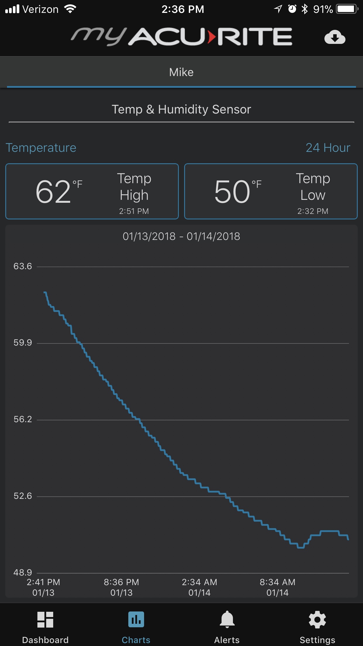

Ambient temperature is plummeting. Down to 59 inside…will probably take a day or so to stabilize.
@rjquillin Alright…It’s definitely chilling! Happy to see it down to an air temp of ~50 degrees, seems as though that’s where the fridge wants to keep it for now as I saw it climb and then go back down again. Also including pics of some other mechanics inside of it in case anyone has any specific recommendations or concerns to share. After things stabilize, I’ll pull the temperature bottle and test the liquid temp using a temp gun to see how it compares to the thermostat temp I’ve selected.

Does this ice formation stay consistent from top to bottom?
@jml326 Ice is more prevalent at the bottom. And, I have the circulation fan on to help keep the temps more stable throughout the cooler. In theory. The fan could actually exaggerate the issue I guess since it forces more airflow. Maybe I should cut it off until the seals are fixed, as I think about it leaving it off should reduce the internal air pressure and may reduce the impact of the bad seals.

Ugh. Well, after it stabilized at 50 for a bit, it then proceeded to get colder and colder. It was down to 43 when I finally pulled the plug. I also pulled out the temperature bottle and used a gun, the internal bottle temp was 45 or so.
It would seem as though the thermostat / temp controller / probe is the culprit at this point since it’s just chilling and chilling and chilling without stopping.

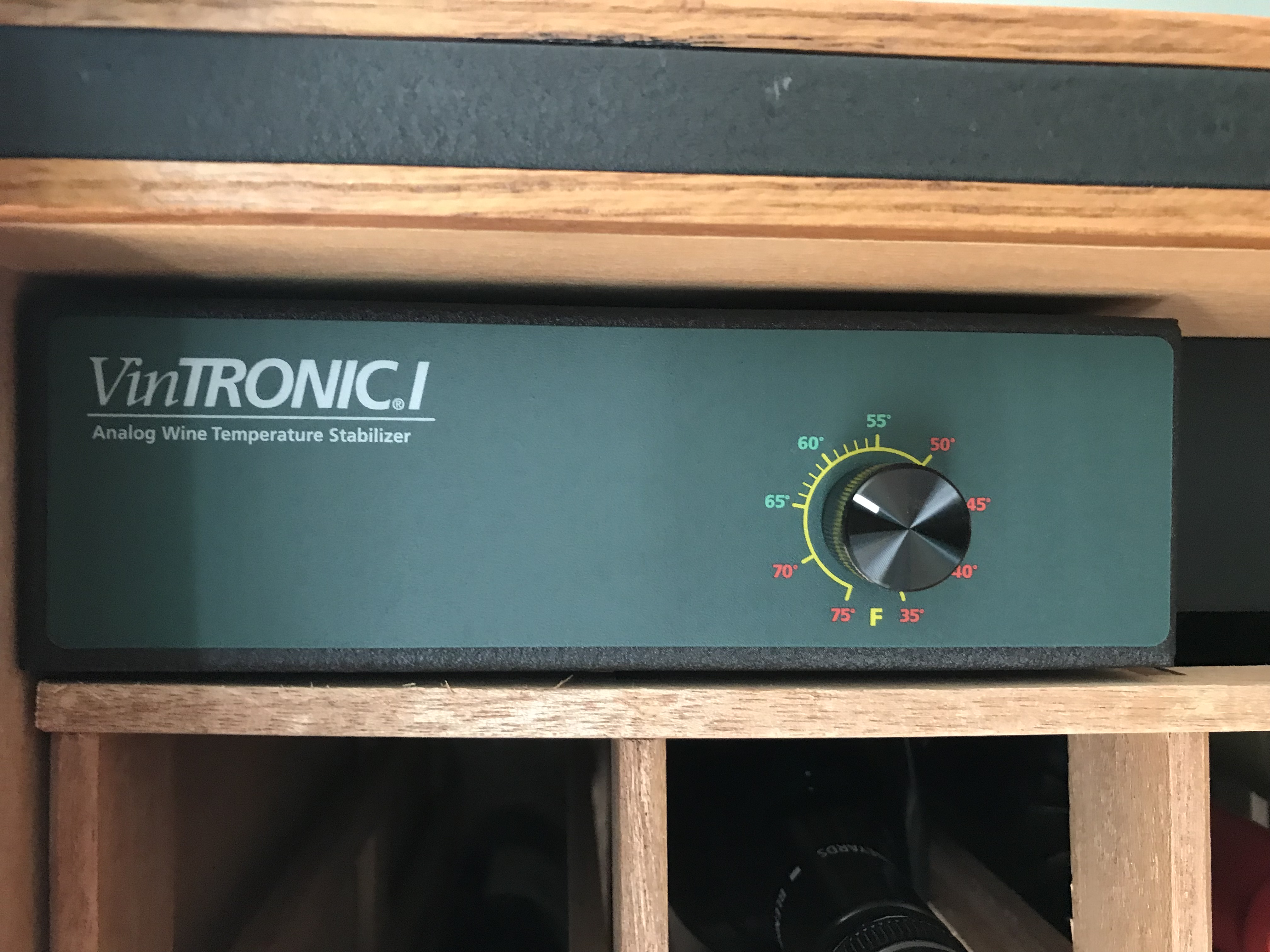

@vaaccess this looks to be little more than a power supply with a few additional tidbits.
It’d be good to find the actual temperature sensor and see what it connects to.

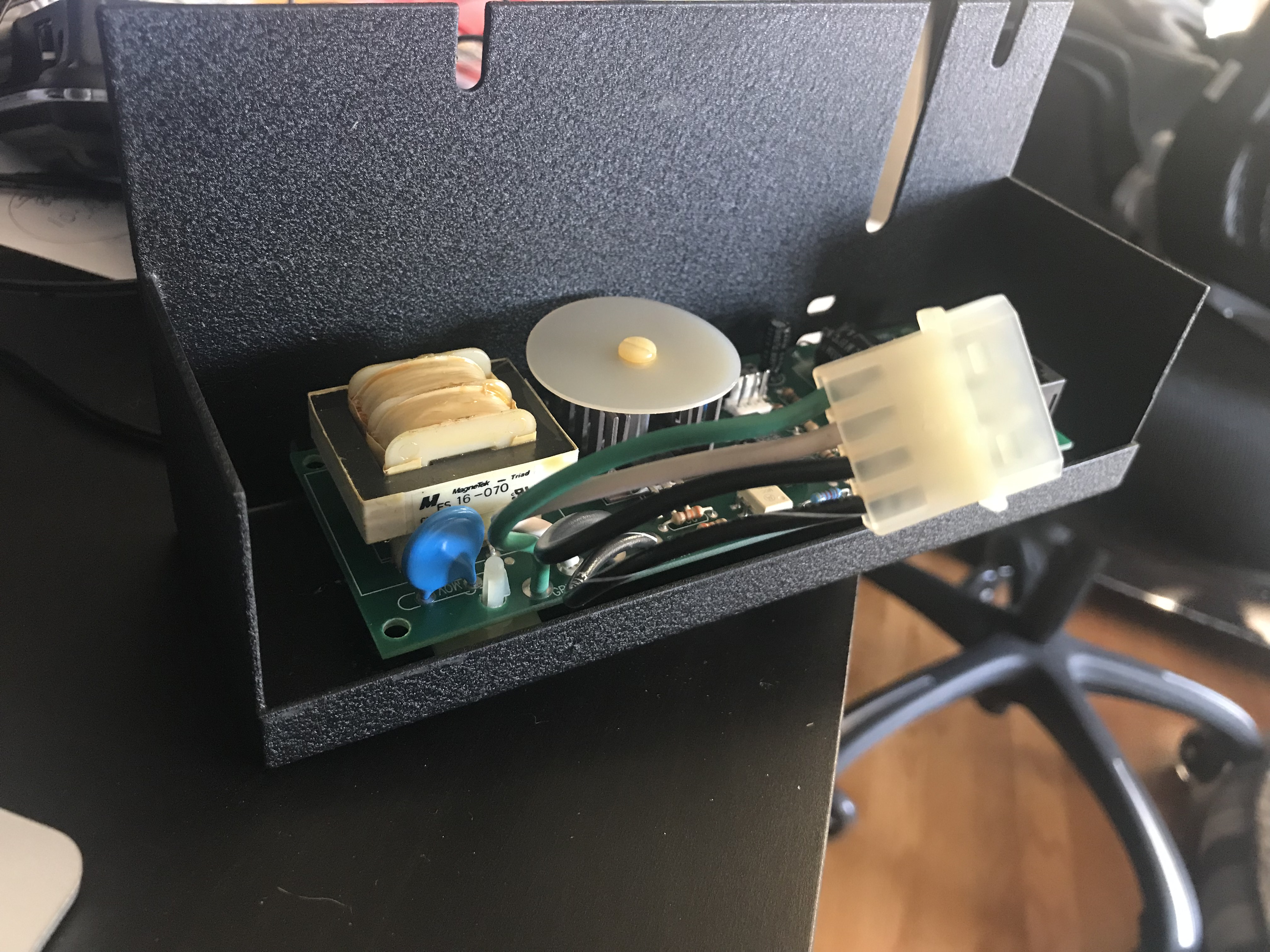

@vaaccess Gotcha. I wonder if it’s a stuck relay. If you put the probe in an ice bath, does the unit still run? Looking at your temp chart, I don’t see the unit going into defrost mode, and the instruction manual states it does so regularly.
@markgm And in theory, that relay or similar should be in here, right? It seems as though the compressor is “dumb” in that it runs when this tells it to run, and stop when it tells it to stop. The Condenser never stops running that I’m aware of…Except when there was a momentary hold in the temp, I’m wondering if the condenser itself got hot or something and paused for a bit…

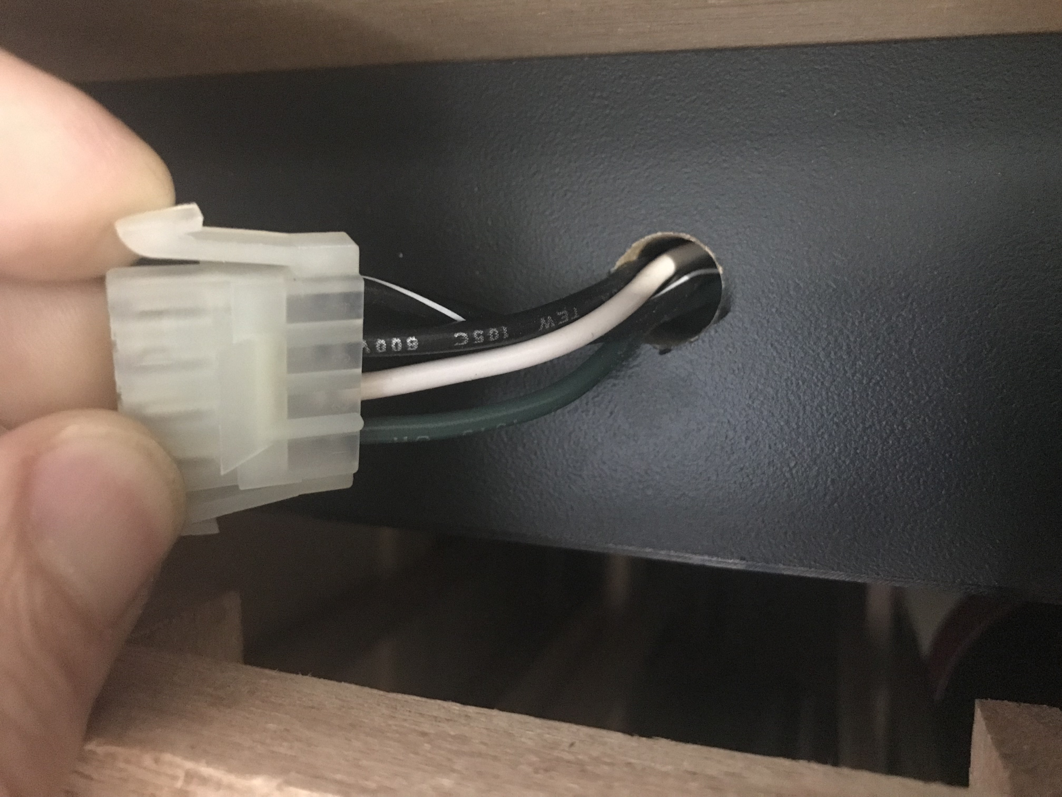

@vaaccess The relay appears to be hidden behind the cord in your picture (the black box). I’m not sure how handy you are, but if you have a multi-meter you could test it for continuity.
@vaaccess And yes, you’re right. The compressor will run so long as that box tells it to. That should be the brains of the unit. When the thermostat reads hot, the relay engages and provides power to the compressor. When it’s too cold, the relay opens and kills power to the compressor. It should also have a timer in there (assuming I found the right manual for your model) that shuts off the compressor for 5 minutes every 90 minutes of runtime.
@markgm Well, I know enough to be dangerous…I had my volt meter out earlier, I was wondering if the temperature probe cable had a broken wire in it, so I cut it and started to test for continuity through the cable. If I was lucky, I’d just need a new cable. But, but tested fine. I’ll just bite the bullet and get the new fancy one they have. Appreciate all your help!

@rjquillin Alright…Got the new control unit installed, the system is running, which is a good sign since this appears to be the brain of the unit. Happy to see a nicer digital interface versus the analog one from before…better alarming/monitoring/etc. Also still using the same water-probe bottle as before, though my wife did put it out with the recycling, but I was able to rescue it!!!
@vaaccess NICE test bottle!
Wouldn’t want to lose that one.
