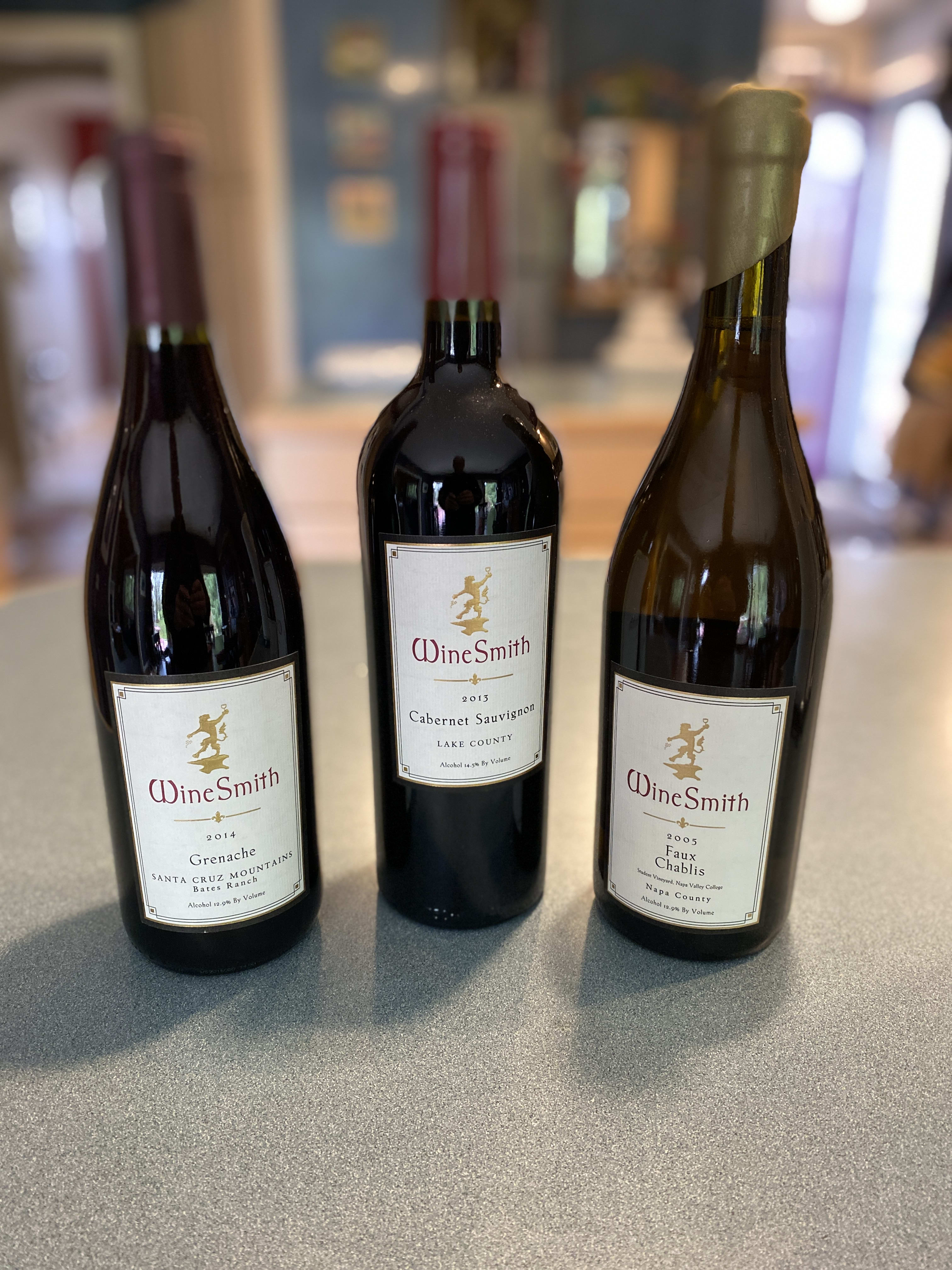

1x 2005 WineSmith Napa Valley Faux Chablis, Student Vineyard, Napa Valley College
1x 2013 WineSmith Cabernet Sauvignon, Lake County
1x 2014 WineSmith Grenache, Bates Ranch, Santa Cruz Mountains
4x 2005 WineSmith Napa Valley Faux Chablis, Student Vineyard, Napa Valley College
4x 2013 WineSmith Cabernet Sauvignon, Lake County
4x 2014 WineSmith Grenache, Bates Ranch, Santa Cruz Mountains

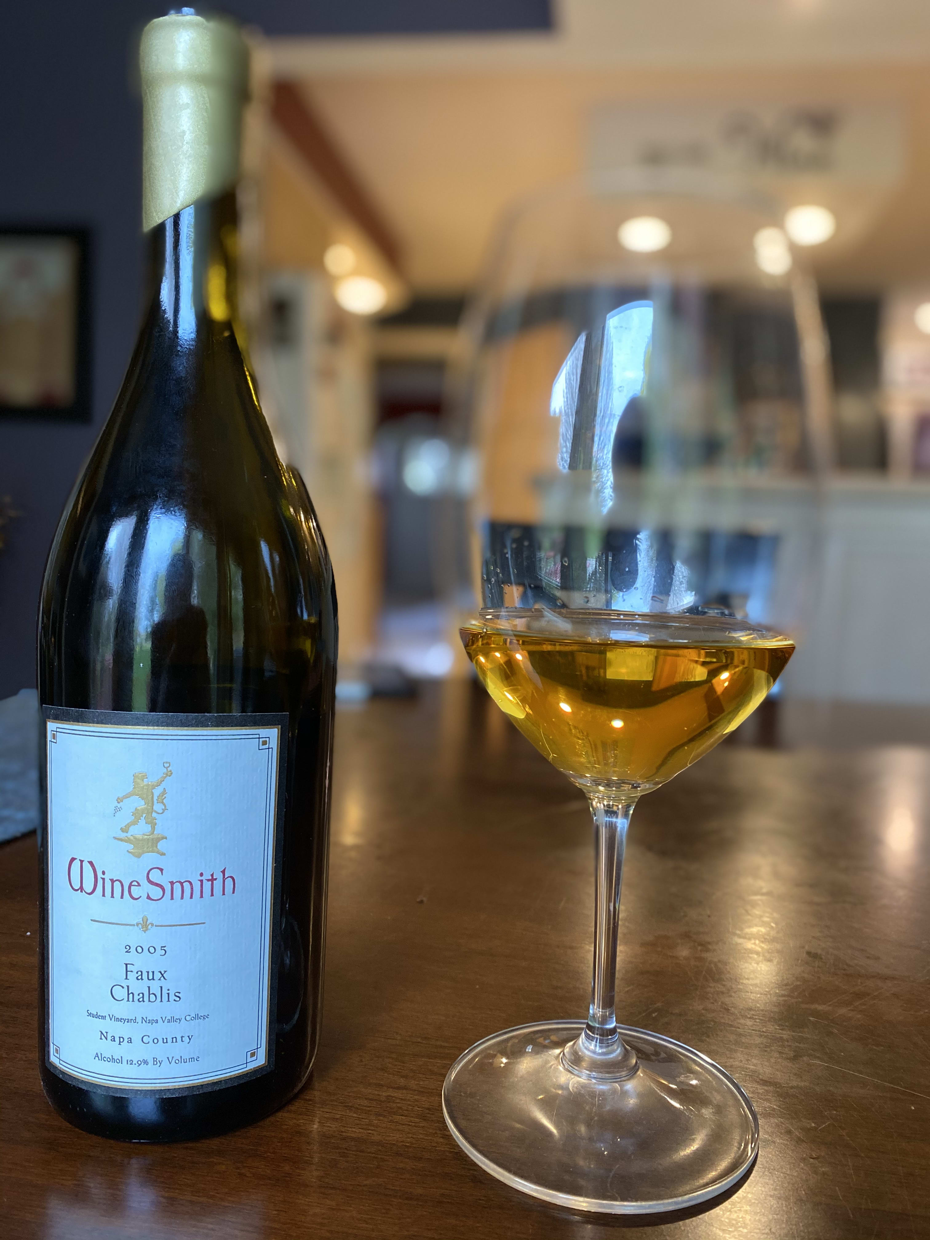

Fresh wild caught sea scallops, risotto, and grean beans, paired with the 2005 Faux Chablis.
Opened (at Clark’s recommendation) with an ah so with no problems for the 15 year old cork. Look at the beautiful golden hue of this wine! Upon opening, I was worried that the wine was flat and worn out, but suspected it just needed a few minutes to stretch its legs after all that time in the bottle. Indeed, after 15 minutes or so, the wine was singing. Fresh nose, definitely that lemon oil Clark talks about on the palate, oily/supple mouth feel, but good acidity and a ton of energy. It came alive at dinner with the scallops, and was at its best at the last glass. Incredible for such an aged Chardonnay. I would love to try it with mussels or oysters. Seafood seems to be its thing.

2005 Faux Chablis
I’ve been drinking the Faux Chablis in one vintage or another since the 2010 rpm Magical History Tour when Clark brought it to Scott and Jana’s as part of a wonderful tasting/party/dinner in the vineyard. I was thoroughly charmed by it then, and have always enjoyed its Chablis-like character. 2005 was a good year in California, with some very nice, rich, ripe Chardonnay’s made in both Napa and Sonoma counties.
Our scores, with highlights of comments:
Appearance (2 pts) rpm, SWMBO, PK, TK – all 2 points- comments included beautiful/great legs
Color (2 pts) rpm, PK, TK – all 2 points, SWMBO 1.5- deep gold, showing age but no browning
Aroma & Bouquet
(6 pts) rpm, TK 4, SWMBO 3.5, PK 3 – the higher scores emphasized apple/earthy-mushroom/vanilla, the lower scores found the nose more resinous to vanilla, with fig fruit.
Total Acidity (2 pts) rpm, SWMBO, TK 2, PK 1.5 (not sure why lower here, all agreed balance good in discussion)
Sweetness, Body (1 each) all scored full points
Flavor (2 points) rpm, TK, PK 2, SWMBO 1.5 - comments included characteristic of Chardonnay, green apple, mild mushroom,
Bitterness and Astringency (1 each) all scored full points.
General Quality (2 pts) TK 2, PK 1.7, rpm, SWMBO 1.5 – comments included not minerally/chalky like Chablis, at peak, drink now.
Total Scores: rpm 17.5, SWMBO 16, PK 16.2, TK 18.
LOOK: Beautiful golden hue in the glass, with great clarity. Slow-forming, medium spaced legs when swirled. SMELL: Lemon butter nose with hints of peach and citrus zest.
TASTE: Golden delicious apple, and Myer lemon with some white peach, general citrus and tropical fruit notes. Light baking spice notes as well, which became more pronounced when the wine was paired with spicy Asian noodles in yakitori sauce.
FINISH/MOUTHFEEL: Some viscosity leads to a creamy, rounded mouthfeel despite medium acidity and Clark’s signature minerality on the tongue. Lip-smacking finish that invites continued sips.
SUMMARY: I looked at my previous tasting notes on CT after finishing the above and see that my current impressions are almost identical, with golden delicious apple and Myer lemon leading the way. However, this bottle had no hint of oxidation like the last one. Tasted much fresher than one would expect from a 15 year old Chardonnay. Clark’s wines are known for their longevity and this is no exception. Very nice wine with or without food, my LW and I greatly enjoyed the bottle and emptied it quickly!

I feel honored this week to have been chosen to LabRat all three of the WineSmith wines in today’s offering! As many know, SWMBO and I are riding out the pandemic season in sunny Southwest Florida… blissfully far from the Frozen North and sadly far from the vineyards of my real home in California. In order to do justice to Clark’s offering, we recruited two additional tasters: PK and his charming and lovely bride TK. PK and TK are knowledgeable, serious, and sophisticated wine drinkers; they’ve lived in France and elsewhere in Europe, and taste seriously and frequently in Napa and Sonoma. If anyone’s worried we violated social distancing protocols, we set up our tasting at opposite ends of an 8-foot table out-of-doors to ensure proper social distancing, and each brought our own glasses, crackers/bread, water, and cheese (for post formal tasting accompaniments). Wine conquers all!
For reference, we used the modified UC Davis 20-point scoring system and Ann Noble’s Wine Aroma Wheel to help us focus on a common vocabulary for our descriptions of the wines. Under this system, most good wines will fall in the range between 15 and 20 points. At the lower end of that range you get the upper end of “standard” wines that have no defects, nothing particularly outstanding about them either. At the upper end are found wines of outstanding character without defect. In my experience over the past 60+ years tasting, wines worth a 20 are rare, usually the wines that give an “AHA!” experience. (Lower scores range from the lower end of standard wines – you may have heard me speak of ‘sound commercial wine’ in the past – on down to those which have noticeable defects, but are still salable (though most Casemates would not consider them ‘drinkable’) on to wines too defective for the trade and completely spoilt wines. OK, I know, enough already! On to the wines!
OVERALL RECOMMENDATION – rpmAUTOBUY – get a case or two! Drink the Faux Chablis this year and next, the Grenache over the next 5-7, and the Cabernet Sauvignon starting in 2023, but save a bottle for 2033 or beyond.
2005 Faux Chablis
Aroma & Bouquet
So overall, it’s clear we all liked the wine, though TK the most and SWMBO the least. TK really likes Chardonnay, SWMBO does too, but does not like either oaky or old Chardonnay, PK is much more a red drinker than white, and rpm like Chardonnay generally, quality Chablis especially. This is a very good bottle of wine, that anyone who doesn’t hate Chardonnay will enjoy, but rpm’s recommendation is that you drink it within the next year or so – see it as peaked, the only question being how long it will hold before it declines. SWMBO would drink it now.

Some notes about the Faux Chablis. Unless you’ve drunk a lot of old style Chablis, say from William Fevre, this is a very difficult wine to spring on somebody.
First of all, there is no vanilla in this wine as it has never seen a barrel. What that is, I believe, is lees character (think Late Disgorged Champagne) from the twice weekly batonage in tank, enhanced by subliminal notes of whiskey lactone, a coconut element from the untoasted Allier chips I put in the fermenter for tannin structure and anti-oxidative properties.
While very fine to drink now, It’s amazingly fresh with no aldehyde. Based on the vertical 2001-2006 tastings I’ve been doing, I think it will be at its best in a couple years, right where the 2003 is now, because the lees character is just beginning to emerge. We have lots of citrus fruit (I call it lemon oil, similar to furniture polish) but the lees add to the “come hither” and are just beginning to emerge.

@winesmith The pleasure was all ours! When I was asked if the Faux Chablis had seen wood, I said I didn’t think so, but if it had, it would have only been neutral older barrels. I hear you on the ‘lemon oil’ , lees, and the ‘late disgorged Champagne’ thoughts, but those notes didn’t come through for any of us. I’m quite fond of LD/RD sparklers and I think I would have picked up on it, but ymmv, and it’s also the case the wine had just flown in a couple of days before… for real fairness, I’d prefer to let a wine rest a few weeks after shipping before going all technical tasting on it
  SWMBO is particularly chary of older Chardonnay, as I had some really old ones we drank past prime (but still alive!) that she really disliked (though I thought were interesting).  BTW, I drank quite a bit of William Fevre Chablis in the late ‘70s and the ‘80s.  I think I see the connection, but the style reminds me more of the grand cru Le Grenouilles we used to get (though honestly, I don’t think it would be fair to compare the FC with Grenouilles). The ‘81 LeGrenouilles didn’t peak until the mid-90s and was still fine at the millennium, though the last bottle we had was sadly faded by 2006…
Comparing this FC to the 2003, I can see waiting a year or so, but not much more.

Was lucky enough to get chosen as a lab rat for this offer from one of my favorite winemakers!
Have tried the Faux Chablis and Grenache so far and will open the Cab later today. While I see that there are a couple lab rat reports posted already, I have not read them nor have I read the descriptions posted by Casemates, so as not to be unduly influenced in my perceptions of the wines.
Having said that, I have previous experience with both the Faux Chablis and Cab but this was my first go at the Grenache, despite having some in my cellar from previous offers. I will compose and post the notes one wine at a time in order to get them up ASAP.
So, without further ado…
